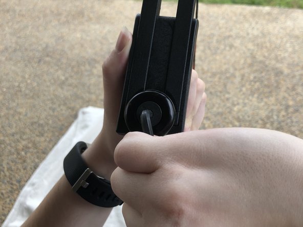

    • Disassemble the bow by using inserting the 3/16th Allen wrench into the hole at the front of the bow.
    • Loosen each side by performing three counter-clockwise turns at the top, three counter-clockwise turns at the bottom, four counter-clockwise turns at the top, and then four counter-clockwise turns at the bottom. There should not be any tension left on the strings.

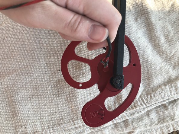

    • To reassemble, twist the two-sided black power cord. Twist it two times and the other side one time.
    • The side that was twisted twice should be placed on the same side as the cable side on the idler wheel.

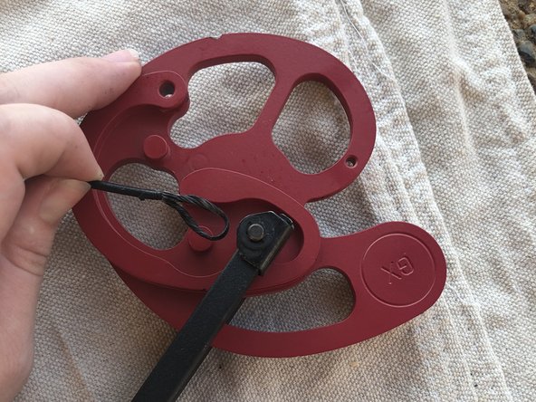

    • Spin the cam until the peg is showing on the inside towards the cable rod. Attach the black power cord to the peg. Make sure it is between the pegs when going through the cam as seen below.

    • Find the end with the longest-serving (the black part of your string) of your black and red string. It is the starting side. As seen in the image the top sting is the longest-serving because it does not have red intertwined. Attach it to the cam on the peg and wrap it around the groove between the limbs and feed it through.
