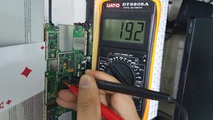

this is my device
check diodes 1: is 1
check diodes 2: is 192

Hello,
I have the same board and it will not run on battery. When I check the same diodes I get the following, No Battery and no power #1 is at 201 and #2 is at 202. When I apply the power #1 becomes at 193 and #2 at Minus 422.
I also looked everywhere for a schematic but no luck.
I feel it is a possible ground issue with the power adapter, i will give you more details next week when i confirm my thought.
von
Also possible that one of the FET's on the battery board itself is in a latch-up state. Carefully short source and drain with a plier shortly and reattach the battery. This happened here as well and this procedure brought the FET's back into a normal state.
