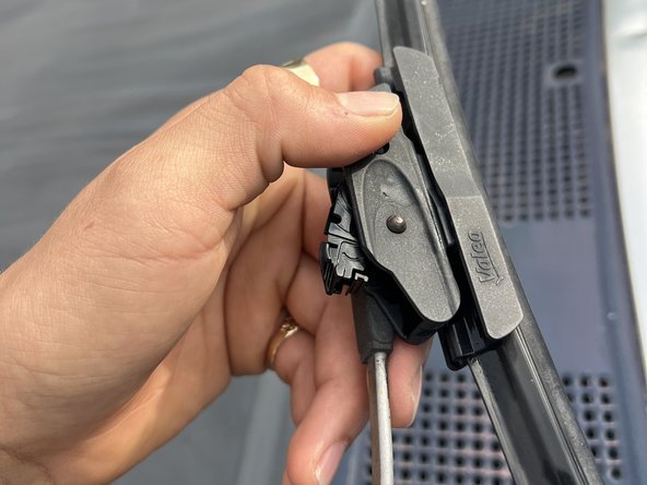

    3. 1992-1996 Ford F-150 Windshield Wiper Blades Replacement: Schritt 3, Bild 1 von 1
      • Push the blade away from the windshield wiper arm and remove.

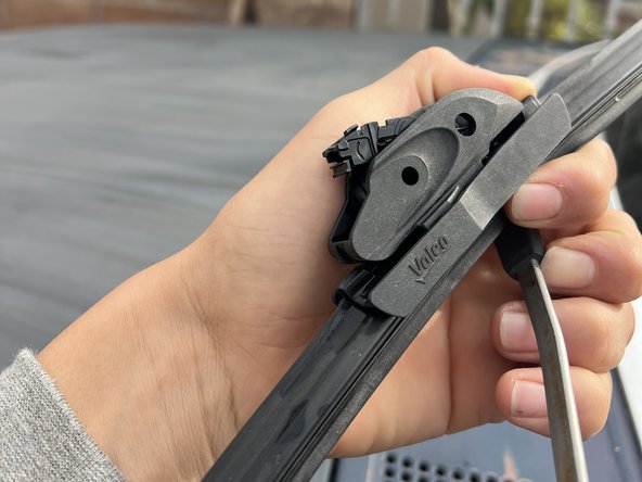

    4. 1992-1996 Ford F-150 Windshield Wiper Blades Replacement: Schritt 4, Bild 1 von 1
      • Grab your new windshield wiper blade and lift up the clip.

    5. 1992-1996 Ford F-150 Windshield Wiper Blades Replacement: Schritt 5, Bild 1 von 2 1992-1996 Ford F-150 Windshield Wiper Blades Replacement: Schritt 5, Bild 2 von 2
      • Insert the windshield wiper blade in the smaller hole.

    6. 1992-1996 Ford F-150 Windshield Wiper Blades Replacement: Schritt 6, Bild 1 von 1
      • Push the clip down until you hear a click.
