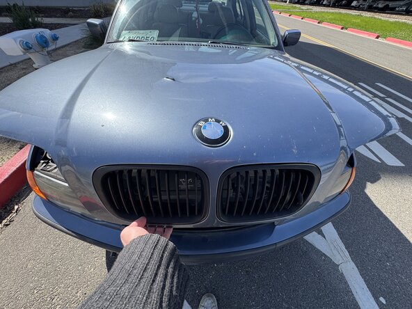

  2. 1999-2006 BMW 3 Series Front Indicator Bulb Replacement: Schritt 2, Bild 1 von 3 1999-2006 BMW 3 Series Front Indicator Bulb Replacement: Schritt 2, Bild 2 von 3 1999-2006 BMW 3 Series Front Indicator Bulb Replacement: Schritt 2, Bild 3 von 3
    • Open the hood by lifting the lever that comes out of the grill, and pulling up on the hood.
    • Watch out for wind that could slam the hood shut!

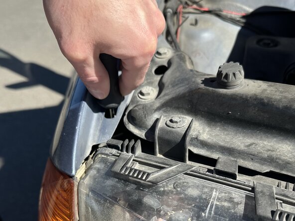

  3. 1999-2006 BMW 3 Series Front Indicator Bulb Replacement: Schritt 3, Bild 1 von 3 1999-2006 BMW 3 Series Front Indicator Bulb Replacement: Schritt 3, Bild 2 von 3 1999-2006 BMW 3 Series Front Indicator Bulb Replacement: Schritt 3, Bild 3 von 3
    • On each front corner there is a pill-shaped access hole in the metal trim.
    • Take a flathead screwdriver and insert it through the access port.
    • Gently push straight down to locate a white plastic tab connected to the indicator assembly.

  4. 1999-2006 BMW 3 Series Front Indicator Bulb Replacement: Schritt 4, Bild 1 von 2 1999-2006 BMW 3 Series Front Indicator Bulb Replacement: Schritt 4, Bild 2 von 2
    • Once you find the tab, push down and towards you to release the indicator assembly.
    • This will take some effort. If the assembly is not budging, reposition the screwdriver and try again.
    • Be careful not to pull the assembly out completely as you might tear the electrical wiring of the bulb.

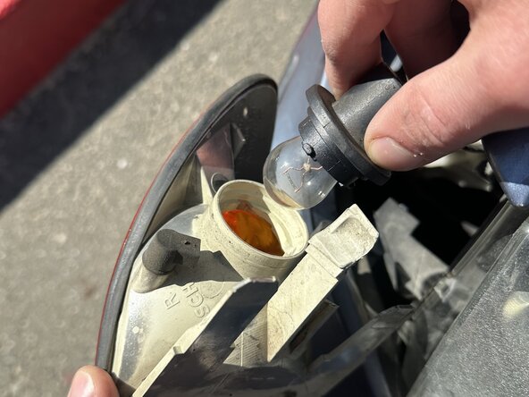

  7. 1999-2006 BMW 3 Series Front Indicator Bulb Replacement: Schritt 7, Bild 1 von 2 1999-2006 BMW 3 Series Front Indicator Bulb Replacement: Schritt 7, Bild 2 von 2
    • Push in the new bulb and screw it clockwise until you feel it lock.
