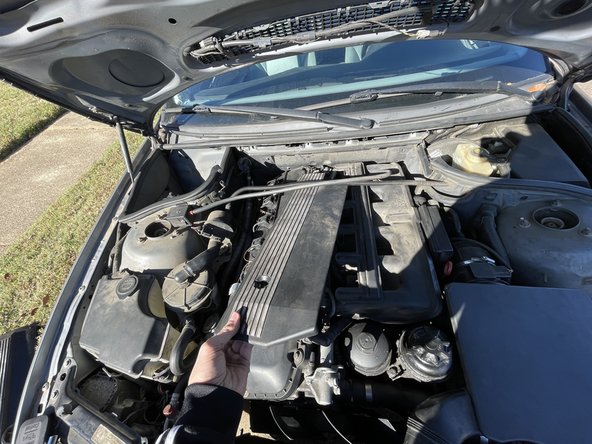

Release the hood latch by pulling the lever found in the driver foot well.
Open the hood.
Using a 10 mm socket wrench, remove the four bolts holding down the engine covers.
Note the placement of each ignition coil then remove the plastic latch and disconnect each cable.
With a firm grip, remove each ignition coil and replace with the new coils respectively.
