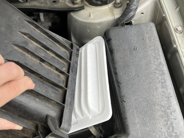

    • Locate the air filter box in the driver side of the engine bay behind the battery.
  4. 2001-2007 Toyota Highlander Engine Air Filter Replacement: Schritt 4, Bild 1 von 3 2001-2007 Toyota Highlander Engine Air Filter Replacement: Schritt 4, Bild 2 von 3 2001-2007 Toyota Highlander Engine Air Filter Replacement: Schritt 4, Bild 3 von 3
    • Unclip the single clip on the box by pulling up on it.
    • Lift the cover up to remove it from the filter.
  5. 2001-2007 Toyota Highlander Engine Air Filter Replacement: Schritt 5, Bild 1 von 3 2001-2007 Toyota Highlander Engine Air Filter Replacement: Schritt 5, Bild 2 von 3 2001-2007 Toyota Highlander Engine Air Filter Replacement: Schritt 5, Bild 3 von 3
    • Lift the air filter up to remove it from the car and replace it with a new one.
