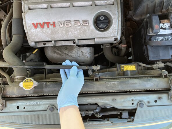

    • Lift and hold the hood open with one hand.
    • Lift the hood prop rod up from the holder in front of the engine.
    • Insert the hoop prop rod into the hole on the underside of the hood.
    • Gently let go of the hood, ensuring the hood prop rod seats properly.
    • Caution: the hood may fall unless the hood prop rod is properly secured in the appropriate slot on the underside of the hood.

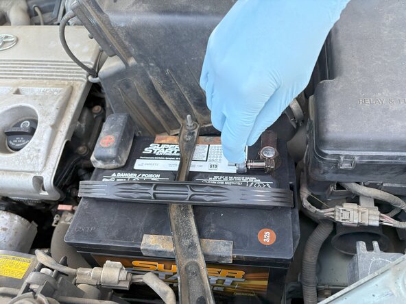

    • Use the 10mm socket wrench to loosen the 10mm bolt holding on the negative (black) lead.
    • Lift the negative (black) wire away from the battery post and set the wire aside so it will not touch the battery post.
    • Lift the plastic cover away from the positive battery post.
    • Lift the positive (red) wire away from the battery post, cover the wire with the plastic cover, and set the wire aside so it will not touch the battery post.
    • WARNING: Order of disconnection matters. Disconnect negative (black) terminal first, then positive (red) terminal.

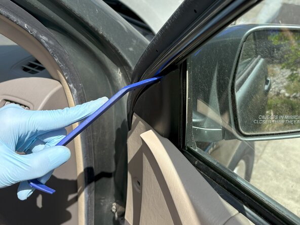

    • Run the plastic trim tool around the lip of the door grip, and gently pry the trimming up to reveal a screw.
    • Remove the screw with a Phillips screwdriver.

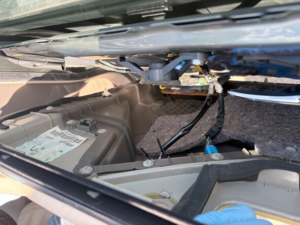

    • Remove the door handle Philips head screw located behind the small flap on the door handle.
    • Gently pry the door handle cover off.

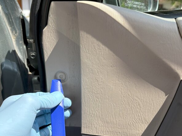

    • Remove the remaining door trim pieces.

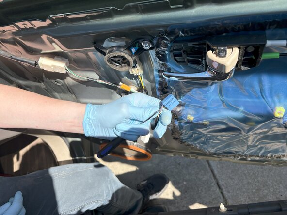

    • Disconnect door lock and window button wires (white and blue connectors).
    • There will still be wiring attached after this step. The remaining wires are disconnected in the next step.
