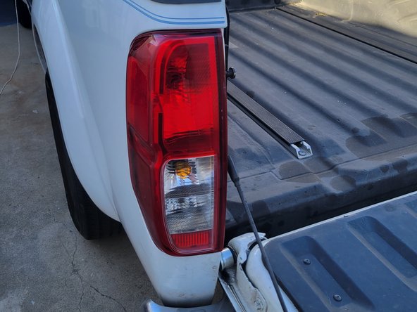

If one or more of the tail lights on your 2005-2020 Nissan Frontier is defective, you'll be able to skip a trip to the dealer by replacing them all on your own with this simple guide. The process is much easier than one might expect, requiring little technical knowledge about cars to complete. As common driving knowledge, functioning outer lights are important for the safety of everyone on the road.
Before starting, you first have to purchase the appropriate replacement bulbs, as each tail light is equipped with three bulbs of varying sizes and colors. Regardless of the specific bulb you are addressing, this guide will be helpful.
Was du brauchst
Twist the bulb within its socket counter-clockwise, then remove it from the inner assembly.
Remove the bulb by pulling directly out of the socket.
Gently place your replacement bulb into the socket.
Insert the socket back into the tail light assembly, then twist clockwise until secure.
Gently place the tail light assembly back into its original position.
Screw back in the Phillips #1 screws.
Close the tail gate.
Turn on your truck to ensure that the lights are in working condition.
