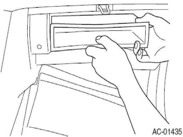

  5. 2005-2009 Subaru Outback Cabin Air Filter Replacement, Remove & replace filter: Schritt 5, Bild 1 von 1
    • Press inward the four tabs on the filter housing and the filter tray out. You need to slide the tray below the upper storage support.
    • Replace the filter. The air flow arrow on the filter must point down.
