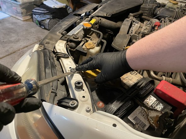

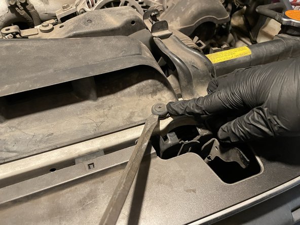

    • Remove the plastic clip holding the windshield washer fluid tank by wedging a flat head screwdriver under the head of the clip and then pulling up on the clip.
    • Push the tank forward and out of the way.

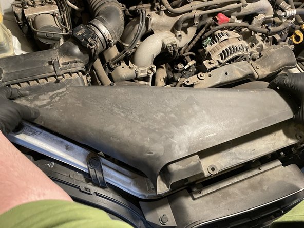

    • Remove the plastic clips holding the air duct on the passengers side by wedging a flat head screwdriver under the head of the clip and then pulling up on the clip.
    • Grab the duct with both hands and pull up and back.

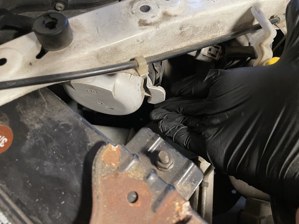

    • Twist the white bulb covers counter-clockwise.
    • Pull the covers off.

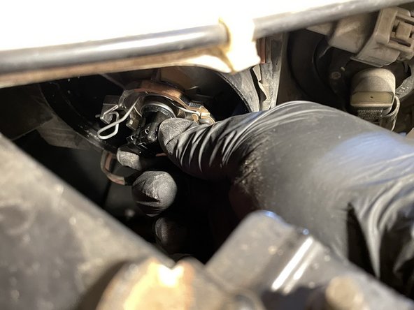

    • Unplug the bulb.
  7. 2005-2009 Subaru Outback Low Beam Headlight Replacement: Schritt 7, Bild 1 von 3 2005-2009 Subaru Outback Low Beam Headlight Replacement: Schritt 7, Bild 2 von 3 2005-2009 Subaru Outback Low Beam Headlight Replacement: Schritt 7, Bild 3 von 3

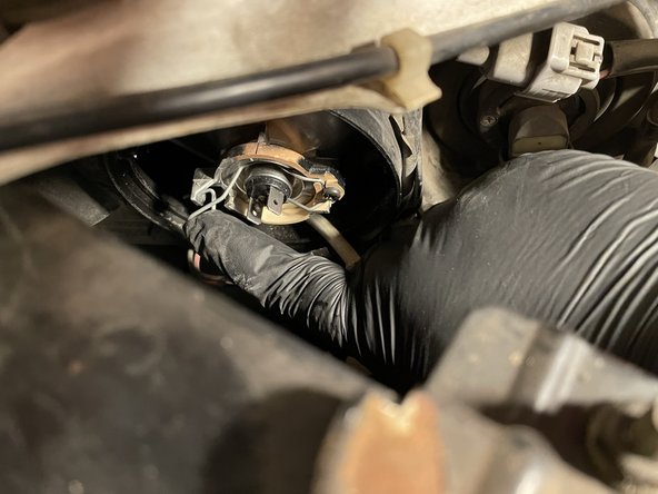

    • Press the metal clip to release the bulb.
    • Remove the old bulb.
