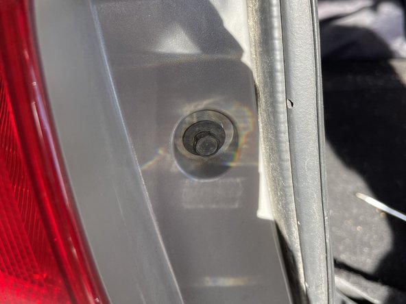

Open the hatch and using a 10MM Socket with a ratchet loosen the bolt holding the tail light assembly in place.
Remove the bolt and set it aside.

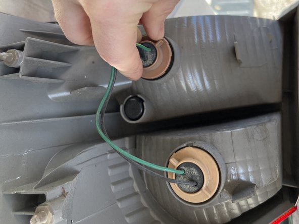

Holding the base of the lightbulb socket, rotate it counter-clockwise to remove it from the light cover.

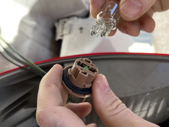

Once the lightbulb socket is removed from the light cover, use two hands to hold the socket and lightbulb and gently pull the lightbulb out of the socket.
Place the new lightbulb into the socket, making sure to line the lightbulb up with the socket correctly.
Once the new lightbulb is installed, return the lightbulb and socket combo to the light cover. Rotate the socket clockwise to click the socket back into place with the tabs.
