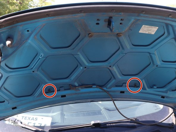

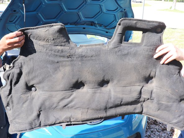

    2. 2008-2016 Ford Fiesta Windshield Washer Nozzle Replacement: Schritt 2, Bild 1 von 3 2008-2016 Ford Fiesta Windshield Washer Nozzle Replacement: Schritt 2, Bild 2 von 3 2008-2016 Ford Fiesta Windshield Washer Nozzle Replacement: Schritt 2, Bild 3 von 3
      • Remove all pins from the cover by firmly bending them out of the hood
      • You can use a mask to prevent inhaling dirt from the cover

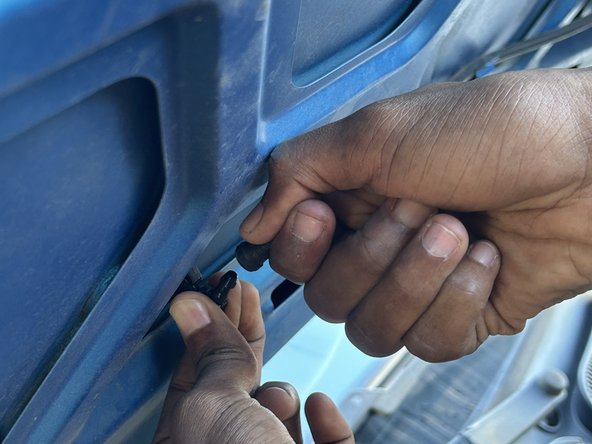

    3. 2008-2016 Ford Fiesta Windshield Washer Nozzle Replacement: Schritt 3, Bild 1 von 3 2008-2016 Ford Fiesta Windshield Washer Nozzle Replacement: Schritt 3, Bild 2 von 3 2008-2016 Ford Fiesta Windshield Washer Nozzle Replacement: Schritt 3, Bild 3 von 3
      • Detach the pressure hose from the washer nozzle.
      • After detaching, examine the pressure hose for any debris that may have accumulated from the old washer nozzle.
