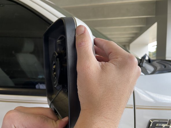

  3. 2009-2014 Ford F-150 Mirror blinker light Replacement, Remove Mirror Glass: Schritt 3, Bild 1 von 2 2009-2014 Ford F-150 Mirror blinker light Replacement, Remove Mirror Glass: Schritt 3, Bild 2 von 2
    • Tilt Mirror Forward and Disconnect Mirror: Locate lock tabs behind the mirror. Apply pressure to all three tabs until the mirror unlatches and you can remove it.

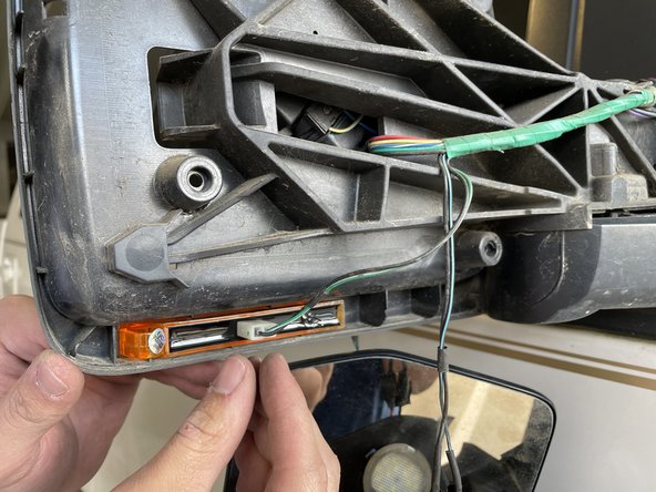

  6. 2009-2014 Ford F-150 Mirror blinker light Replacement, Disconnect Old Blinker Light: Schritt 6, Bild 1 von 2 2009-2014 Ford F-150 Mirror blinker light Replacement, Disconnect Old Blinker Light: Schritt 6, Bild 2 von 2
    • Remove old mirror blinker light from the mirror frame.
    • Disconnect the plug from the rear of the blinker light.

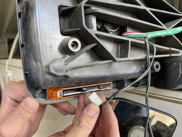

  7. 2009-2014 Ford F-150 Mirror blinker light Replacement, Install New Mirror Blinker Light: Schritt 7, Bild 1 von 3 2009-2014 Ford F-150 Mirror blinker light Replacement, Install New Mirror Blinker Light: Schritt 7, Bild 2 von 3 2009-2014 Ford F-150 Mirror blinker light Replacement, Install New Mirror Blinker Light: Schritt 7, Bild 3 von 3
    • Install New Mirror Blinker Light: Slide new light into the mirror and press firmly until you hear a click.
  8. 2009-2014 Ford F-150 Mirror blinker light Replacement, Connecting Wires to New Blinker Light: Schritt 8, Bild 1 von 2 2009-2014 Ford F-150 Mirror blinker light Replacement, Connecting Wires to New Blinker Light: Schritt 8, Bild 2 von 2
    • Connect new blinker light by plugging wire into the back of the blinker light.
