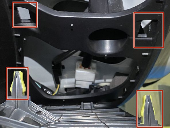

To put the panel back, put the 2 clips at the bottom of the panel into the locks.
Put the middle clips into their place, you will hear a click when the middle two clips are in place.
Put the top 2 remaining clips of the panel into their locks.
