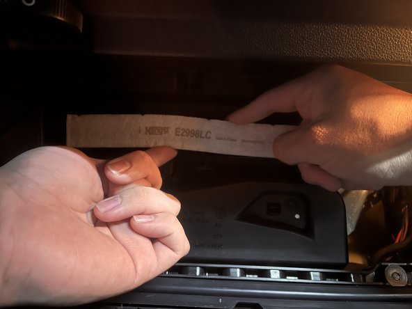

    • After removing the honeycomb compartment, set it aside.
    • Remove the old cabin air filter and throw it out.
    • If the filter does not slide out immediately, try pinching on the filter and pulling it out.
  4. 2015-2021 Volkswagen GTI Cabin Air Filter Replacement: Schritt 4, Bild 1 von 3 2015-2021 Volkswagen GTI Cabin Air Filter Replacement: Schritt 4, Bild 2 von 3 2015-2021 Volkswagen GTI Cabin Air Filter Replacement: Schritt 4, Bild 3 von 3
    • When installing the new air filter, notice the direction of the arrows on your old one.
    • Make sure to have the air flow arrows facing the same way (down). Push into the empty compartment.
