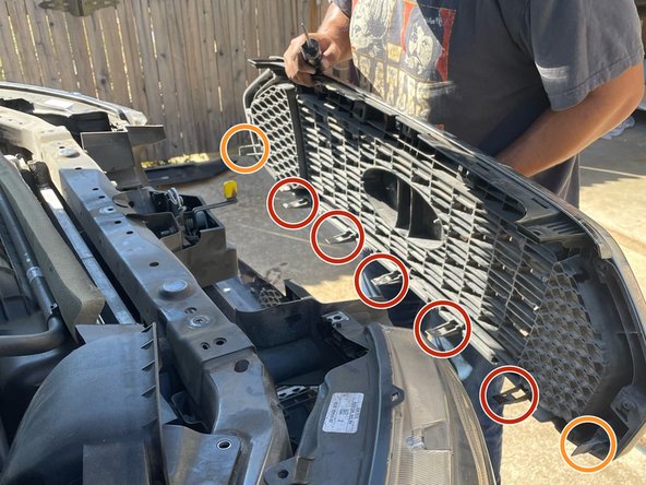

  8. 2019-2023 Ford Ranger Headlight Replacement: Schritt 8, Bild 1 von 3 2019-2023 Ford Ranger Headlight Replacement: Schritt 8, Bild 2 von 3 2019-2023 Ford Ranger Headlight Replacement: Schritt 8, Bild 3 von 3
    • Push down on the plastic clips to release them.
    • Push outwards on the outer clips to release them.
    • Pull the grill directly towards you once the all clips are released.
    • These clips are plastic and brittle. Be patient to make sure they do not break.
    • Removing the grill will take considerably longer than other steps since clips on one side have a tendency to snap back in once you move to the other.
