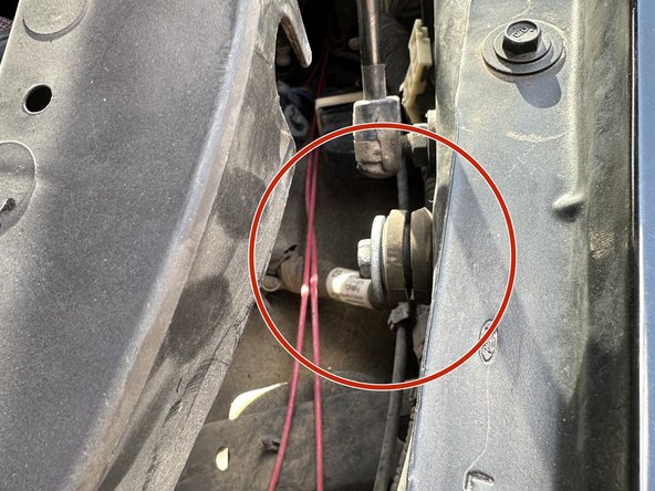

    • Before you begin, make sure the truck is turned off and in park.
    • Open the hood and ensure it is securely propped up.

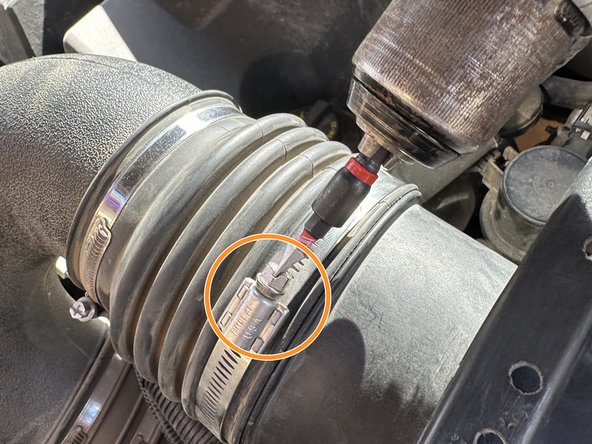

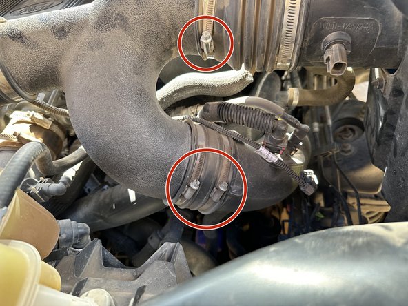

    • Loosen the clamps on the factory air intake using a flathead screwdriver.

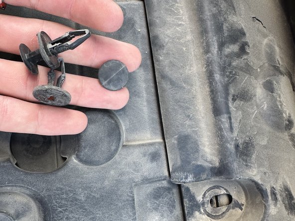

    • Remove the clips from the stock air suction hose

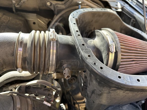

    • Connect the new dual air hoses to the stock air hose and tighten them using a flathead screwdriver.
    • Attach the stock air scoop to the casing of the new intake using a 6mm socket and bolt.

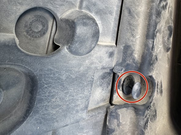

    • Remove the stock 12mm screw using a socket, then place the grommet on before screwing it back in. Leave enough space for the new air intake casing to fit securely into the grommet.

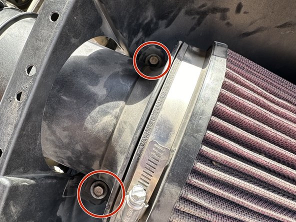

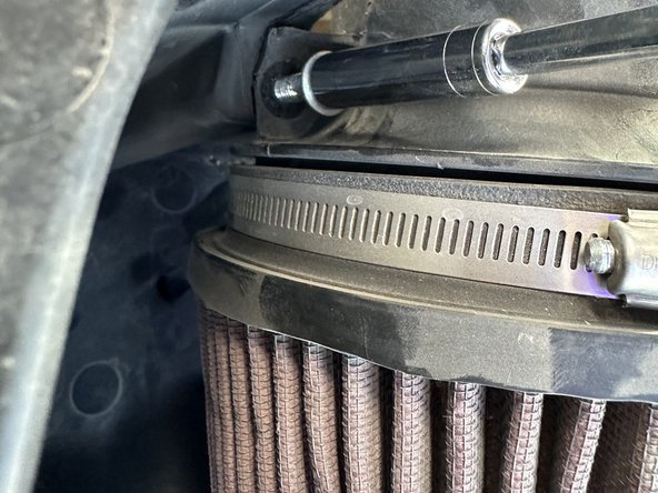

    • Bolt in the two 8mm bolts that secure the new air filter.
    • Once secured, fit the new air filter into place.

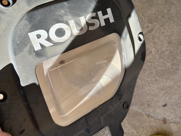

    • If desired, apply the decorative "Roush" sticker to the air intake casing cover, which represents the brand of the new intake filter.

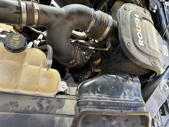

    • After attaching the sticker, place the casing on for appearance purposes.
    • Bolt in the 6 T20 Torx screws to secure the casing.
    • Once all 6 T20 Torx bolts are tightened, you've successfully installed your brand new cold air intake, which improves airflow and boosts both performance and efficiency.
