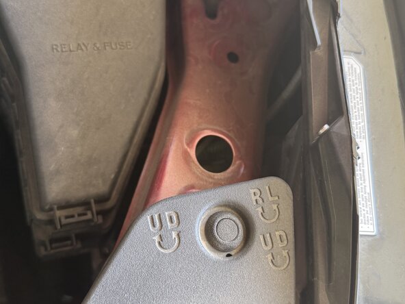

  3. 2021 Toyota Highlander Hybrid Front Side Marker Light Replacement: Schritt 3, Bild 1 von 3 2021 Toyota Highlander Hybrid Front Side Marker Light Replacement: Schritt 3, Bild 2 von 3 2021 Toyota Highlander Hybrid Front Side Marker Light Replacement: Schritt 3, Bild 3 von 3
    • Wait until the bulb has cooled completely before touching it to avoid burns.
    • Locate the marker light bulb socket.
    • It is typically located on the back of the light housing, behind the headlight assembly.

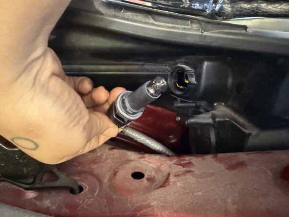

  4. 2021 Toyota Highlander Hybrid Front Side Marker Light Replacement: Schritt 4, Bild 1 von 3 2021 Toyota Highlander Hybrid Front Side Marker Light Replacement: Schritt 4, Bild 2 von 3 2021 Toyota Highlander Hybrid Front Side Marker Light Replacement: Schritt 4, Bild 3 von 3
    • Gently turn the bulb socket a quarter turn counter-clockwise to unlock it.
    • Pull the socket directly out of the housing.
    • Don’t pull on it too much, or you could risk disconnecting the cables attached to the socket.

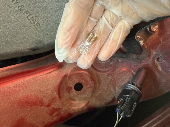

  5. 2021 Toyota Highlander Hybrid Front Side Marker Light Replacement: Schritt 5, Bild 1 von 3 2021 Toyota Highlander Hybrid Front Side Marker Light Replacement: Schritt 5, Bild 2 von 3 2021 Toyota Highlander Hybrid Front Side Marker Light Replacement: Schritt 5, Bild 3 von 3
    • Pull the old bulb straight out of the socket.
  6. 2021 Toyota Highlander Hybrid Front Side Marker Light Replacement: Schritt 6, Bild 1 von 2 2021 Toyota Highlander Hybrid Front Side Marker Light Replacement: Schritt 6, Bild 2 von 2
    • Align the new bulb with the socket and push it firmly into place.
    • Try to shake the socket to ensure the bulb is securely in place.
  7. 2021 Toyota Highlander Hybrid Front Side Marker Light Replacement: Schritt 7, Bild 1 von 2 2021 Toyota Highlander Hybrid Front Side Marker Light Replacement: Schritt 7, Bild 2 von 2
    • Insert the light socket into the housing.
    • Twist it clockwise to secure it in place.
    • You should hear a click or feel it click into place. That’s how you know it is secure.
