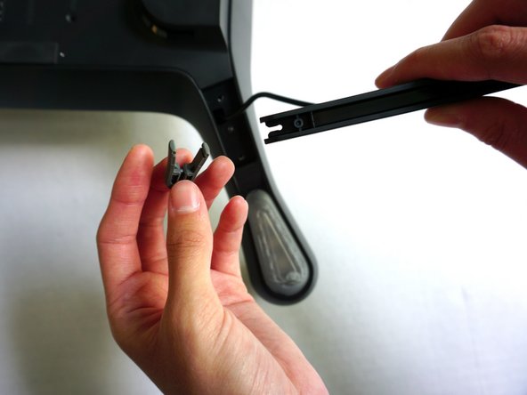

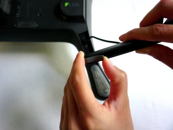

    4. 3DR Solo Leg Replacement: Schritt 7, Bild 1 von 3 3DR Solo Leg Replacement: Schritt 7, Bild 2 von 3 3DR Solo Leg Replacement: Schritt 7, Bild 3 von 3
      • Locate the rubber grip at the end of the leg and, with your thumb, peel it back and pull it off.

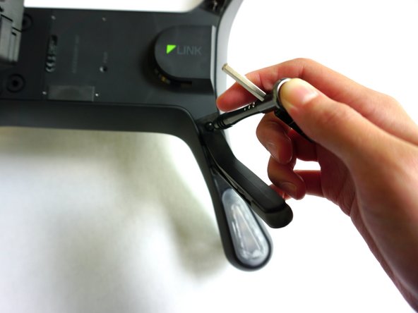

    5. 3DR Solo Leg Replacement: Schritt 8, Bild 1 von 2 3DR Solo Leg Replacement: Schritt 8, Bild 2 von 2
      • Leg type 1 will contain a 1mm screw at the base of the leg.
      • Unscrew the 1mm screw located at the end of the leg.

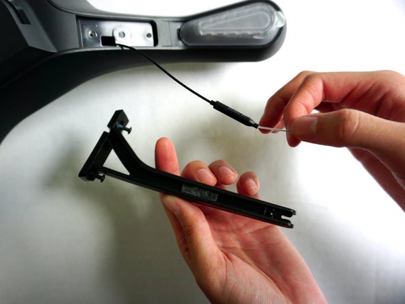

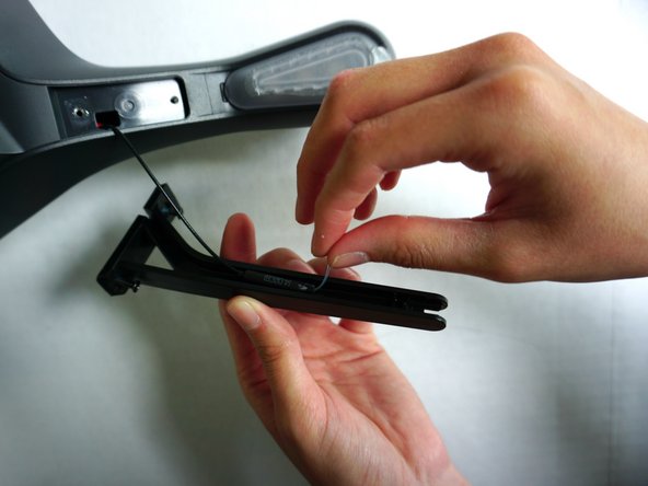

    7. 3DR Solo Leg Replacement: Schritt 10, Bild 1 von 3 3DR Solo Leg Replacement: Schritt 10, Bild 2 von 3 3DR Solo Leg Replacement: Schritt 10, Bild 3 von 3
      • Leg type 2 will contain the antenna wire.
      • Gently pull up on and remove the plastic covering labeled "solo antenna".
      • Locate the antenna wire and carefully pull up and remove it.
      • The antenna wire is flimsy so use caution upon removal.
