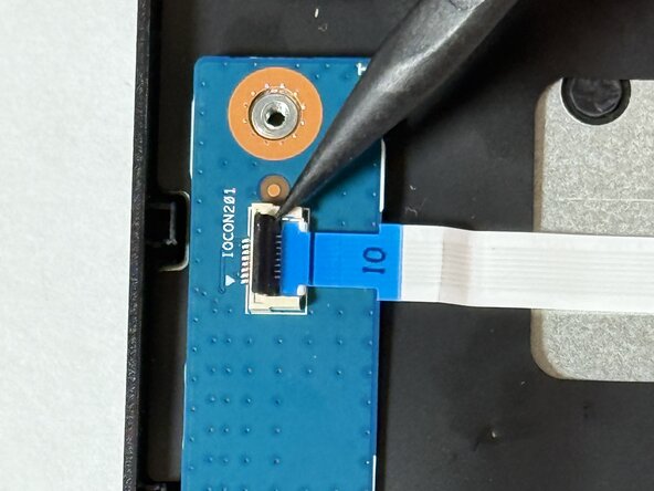

  6. Acer Chromebook CB0311-1H-C1MX Daughterboard Replacement, Daughterboard: Schritt 6, Bild 1 von 1
    • Using the JIS #1 screwdriver, remove one 4.7 mm screw from the daughterboard.
  7. Acer Chromebook CB0311-1H-C1MX Daughterboard Replacement: Schritt 7, Bild 1 von 3 Acer Chromebook CB0311-1H-C1MX Daughterboard Replacement: Schritt 7, Bild 2 von 3 Acer Chromebook CB0311-1H-C1MX Daughterboard Replacement: Schritt 7, Bild 3 von 3
    • Lift the black tab and disconnect the motherboard cable.
  8. Acer Chromebook CB0311-1H-C1MX Daughterboard Replacement: Schritt 8, Bild 1 von 1
    • Gently lift out the first piece of the daughterboard.
  9. Acer Chromebook CB0311-1H-C1MX Daughterboard Replacement: Schritt 9, Bild 1 von 1
    • Using the JIS #1 screwdriver, remove two 4.7 mm screws.
  10. Acer Chromebook CB0311-1H-C1MX Daughterboard Replacement: Schritt 10, Bild 1 von 1
    • Using the iFixit opening pick, pry up the hinge holding the daughterboard in place.
  11. Acer Chromebook CB0311-1H-C1MX Daughterboard Replacement: Schritt 11, Bild 1 von 1
    • Gently lift out the second piece of the daughterboard.
