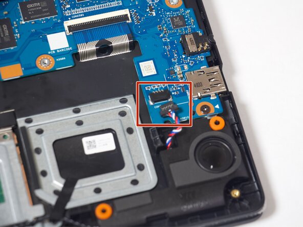

  11. Acer Chromebook CB0311-1H-C1MX Motherboard Replacement: Schritt 11, Bild 1 von 2 Acer Chromebook CB0311-1H-C1MX Motherboard Replacement: Schritt 11, Bild 2 von 2
    • Disconnect the speaker cable by pulling it straight out.

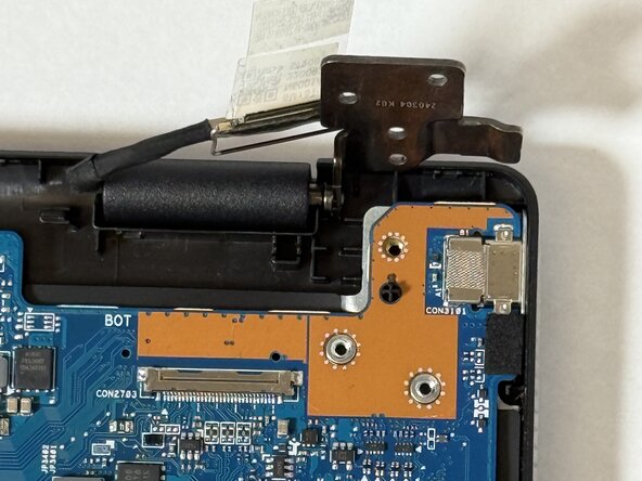

  16. Acer Chromebook CB0311-1H-C1MX Motherboard Replacement: Schritt 16, Bild 1 von 2 Acer Chromebook CB0311-1H-C1MX Motherboard Replacement: Schritt 16, Bild 2 von 2
    • Using the iFixit opening pick, pry up the hinge holding the motherboard in place.
  17. Acer Chromebook CB0311-1H-C1MX Motherboard Replacement: Schritt 17, Bild 1 von 1
    • Gently lift out the motherboard.
