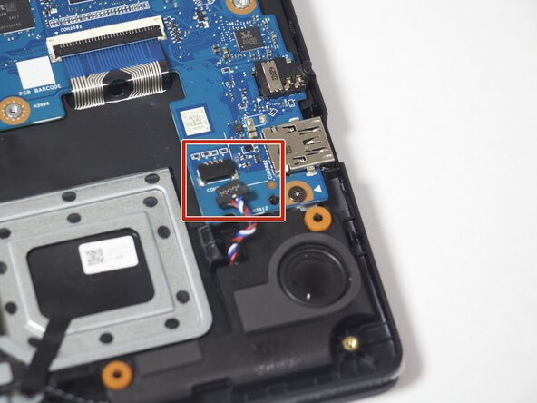

  6. Acer Chromebook CB0311-1H-C1MX Speaker Replacement, Speaker: Schritt 6, Bild 1 von 2 Acer Chromebook CB0311-1H-C1MX Speaker Replacement, Speaker: Schritt 6, Bild 2 von 2
    • Disconnect the speaker cable from the motherboard by pulling it straight out.
  7. Acer Chromebook CB0311-1H-C1MX Speaker Replacement: Schritt 7, Bild 1 von 2 Acer Chromebook CB0311-1H-C1MX Speaker Replacement: Schritt 7, Bild 2 von 2
    • Lift the speaker out, taking care to unweave the cord from the metal prongs.
    • There may be tape holding down parts of the speaker.
