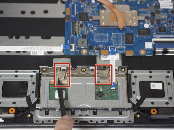

    • Peel back or remove the two pieces of grey tape holding the touchpad in place.
  10. Acer Chromebook CB0311-1H-C1MX Touch Pad Replacement: Schritt 10, Bild 1 von 2 Acer Chromebook CB0311-1H-C1MX Touch Pad Replacement: Schritt 10, Bild 2 von 2

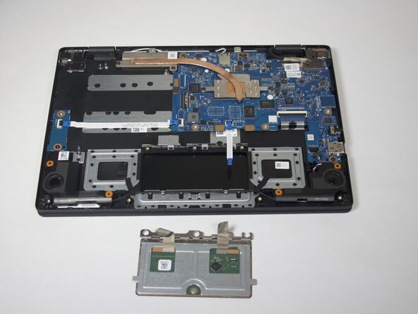

    • Gently lift the touchpad up and out.
