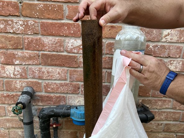

  4. Aquasana F-300R 300,000 Gallon Whole House Water Filtration System 20-Inch Sediment Pre-Filter Replacement: Schritt 4, Bild 1 von 1
    • Remove the dirty pre-filter and dispose of it.

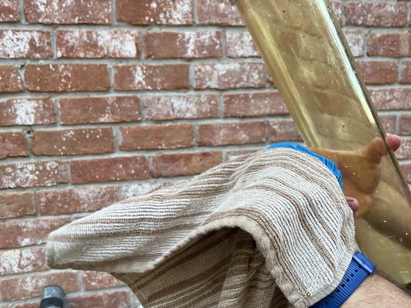

    • Wash the filter housing canister with dish soap and water.
    • You may need a long-handled cleaning brush to scrub off dirt and debris.
    • Rinse and dry the filter housing canister.
