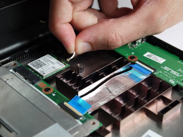

Placing the Chromebook in the upright position, the LAN card is located on the upper right side of the shell.
The LAN card is pinned down with 2 coaxial connectors: main power and auxiliary input.
To disconnect, gently pull off the two connections using an upwards motion.

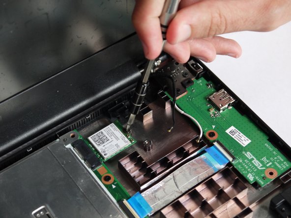

On the right side of the LAN card is a 3.4mm Phillips head screw.
Using the J0 Phillips Head Tip from your tool kit, remove the screw, turning counter clockwise until the screw is free.

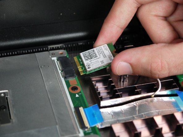

At this point, the LAN card is only connected to the CPU.

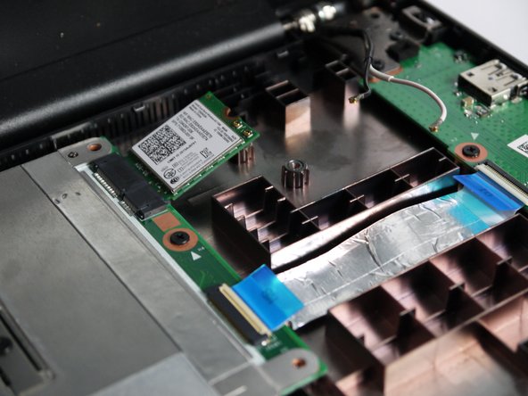

To remove, gently slide out the LAN card from the CPU’s input clip.
The LAN card is now disconnected.
