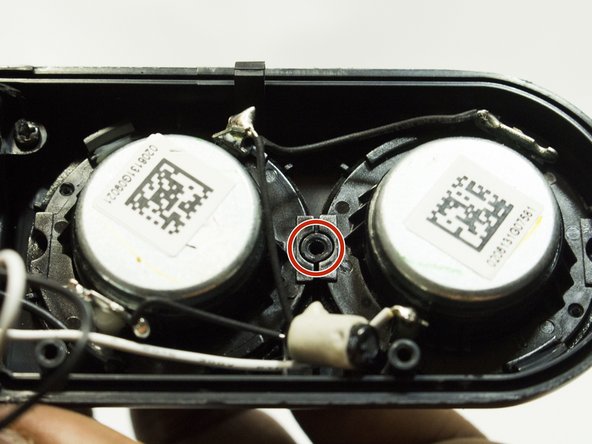

  7. Beats Pill 1.0 Lautsprecher austauschen, Lautsprecher: Schritt 7, Bild 1 von 2 Beats Pill 1.0 Lautsprecher austauschen, Lautsprecher: Schritt 7, Bild 2 von 2
    • Drehe die beiden Kreuzschlitzschrauben #0 heraus, welche die Lautsprecher befestigen.
    Frag FixBot
  8. Beats Pill 1.0 Lautsprecher austauschen: Schritt 8, Bild 1 von 1
    • Jeder Lautsprecher wird von zwei Klammern festgehalten. Drücke den Lautsprecher von der Vorderseite her nach außen und gleichzeitig eine der Halteklammern zur Seite. Der Lautsprecher sollte dann herauskommen.

Do you have a link to the speakers that are used for the speaker pill, the current one seems to be broken and I cant find the replacements anywhere
justin perez - Antwort Teilen
Just wanted to add a comment regarding where to find the actual replacement speakers for the Beats Pill 1.0. I quite certain that the over all size of each individual speaker is 1" including the plastic bezel around the speaker. The actual size of the speaker itself is 3/4" and I believe I have found a replacement speaker to use if one of the speakers in your Beats Pill 1.0 gets blown or damaged. Below is the link to the replacement speaker, found on www.partsexpress.com. It looks almost identical to the stock speaker installed in the Pill 1.0, minus the custom bezel around the speaker that is used to secure the speakers inside the Pill.
http://www.parts-express.com/tymphany-pm...
Buying all 4 speakers at once saves you 75 cent compared to the price of buying just a single speaker.
Hope this helps anyone looking for replacement speakers for their Beats Pill 1.0
Brad Shirer - Antwort Teilen
I just got all 4 new speakers to replace the older ones as the rubber rims have all soften and sort of disintegrated/damaged. Only problems with the replacement speakers plastic body are not same as original ones. So the speakers won’t fit the 2 clips, so almost no way to secure the speakers. Probably need to be Super glue.
