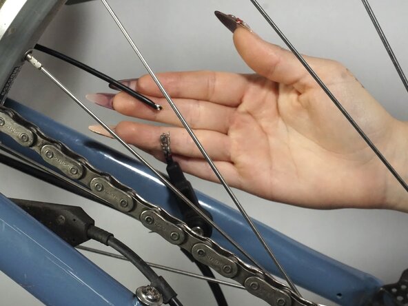

  4. Bluejay Premiere Lite E-Bike Mileage Cord Replacement: Schritt 4, Bild 1 von 1
    • Cut off the broken cord that is attached to the bike motor with wire cutters.
    • Do not cut off the entire broken cord. Leave about 3 to 4 inches to give yourself enough space when soldering.

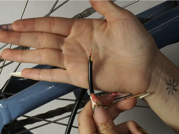

  5. Bluejay Premiere Lite E-Bike Mileage Cord Replacement: Schritt 5, Bild 1 von 2 Bluejay Premiere Lite E-Bike Mileage Cord Replacement: Schritt 5, Bild 2 von 2
    • Use the box cutter and cut the cord protector at an angle.
    • Scrape until the three-color wire is revealed.

  6. Bluejay Premiere Lite E-Bike Mileage Cord Replacement: Schritt 6, Bild 1 von 2 Bluejay Premiere Lite E-Bike Mileage Cord Replacement: Schritt 6, Bild 2 von 2
    • Repeat step 5 for the end of the cord still attached to the bike motor and both ends of the replacement cord.

  7. Bluejay Premiere Lite E-Bike Mileage Cord Replacement: Schritt 7, Bild 1 von 2 Bluejay Premiere Lite E-Bike Mileage Cord Replacement: Schritt 7, Bild 2 von 2
    • Use pliers to twist each colored wire in the replacement cord so the individual strands spread apart.
    • Do this for every exposed wire in the mileage sensor and the cord attached to the bike motor.
    • This step will ensure that each colored wire is clearly separated and is ready to be reattached.
