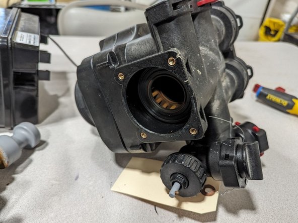

Using a #2 Phillips screwdriver, remove the four screws securing the piston assembly
Using your fingers, pull the seals and spacers out of the valve body.
Lubricate the center and outer edge of each seal and spacer using a food-grade silicone lubricant
Use of another lubricant can cause swelling and failure of components.
Insert the new seals and spacers into the valve body.
Install in the following order: seal then spacer.
The first one in will be a seal and the last one in before the piston will be a seal.
Lubricate the new piston assembly with a FOOD GRADE SILICONE LUBRICANT.
Slide the piston into the hole at the center of the seals and spacers.
Using a #2 phillips screwdriver reinstall the 4 screws securing the piston assembly to the valve body.
