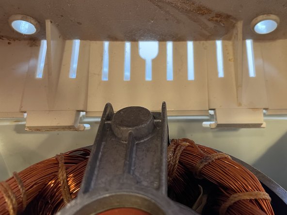

    2. Cuisinart Robot Coupe CFP 4  5  5A  9  9A  RC 2000 and 2100 Food Processor Silicone Safety Switch Cover Replacement, Separate Motor Case: Schritt 2, Bild 1 von 3 Cuisinart Robot Coupe CFP 4  5  5A  9  9A  RC 2000 and 2100 Food Processor Silicone Safety Switch Cover Replacement, Separate Motor Case: Schritt 2, Bild 2 von 3 Cuisinart Robot Coupe CFP 4  5  5A  9  9A  RC 2000 and 2100 Food Processor Silicone Safety Switch Cover Replacement, Separate Motor Case: Schritt 2, Bild 3 von 3
      • Carefully separate the motor housing case, first from the side where you removed the two flat head screws. Then gently pivot this front edge and you should be able to carefully open and separate the tabs on the back side of the bottom of the motor cover case. Be careful not to break these plastic tabs. Set this piece aside for reassembly.

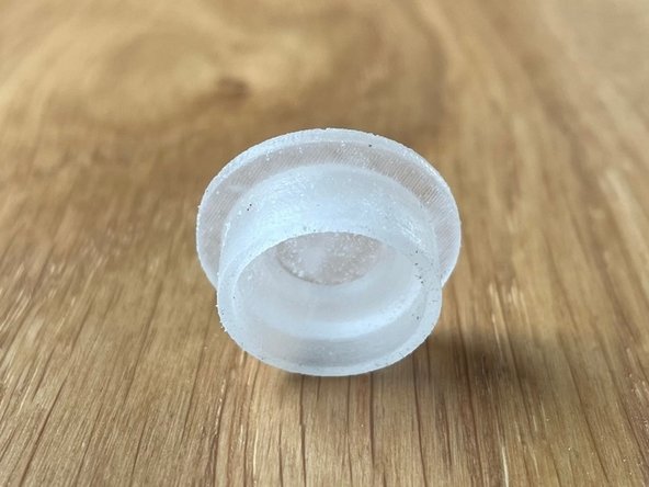

    7. Cuisinart Robot Coupe CFP 4  5  5A  9  9A  RC 2000 and 2100 Food Processor Silicone Safety Switch Cover Replacement, Insert New Silicone Safety Switch Cover: Schritt 7, Bild 1 von 3 Cuisinart Robot Coupe CFP 4  5  5A  9  9A  RC 2000 and 2100 Food Processor Silicone Safety Switch Cover Replacement, Insert New Silicone Safety Switch Cover: Schritt 7, Bild 2 von 3 Cuisinart Robot Coupe CFP 4  5  5A  9  9A  RC 2000 and 2100 Food Processor Silicone Safety Switch Cover Replacement, Insert New Silicone Safety Switch Cover: Schritt 7, Bild 3 von 3
      • Insert your new Silicon Safety Switch Cover onto the clear plastic holder. The "V" notches should face towards the switch push button.
      • Then replace this holder with Silicone Switch cover back into the motor housing.

    10. Cuisinart Robot Coupe CFP 4  5  5A  9  9A  RC 2000 and 2100 Food Processor Silicone Safety Switch Cover Replacement, Some Images of the New Silicone Safety Switch Cover: Schritt 10, Bild 1 von 3 Cuisinart Robot Coupe CFP 4  5  5A  9  9A  RC 2000 and 2100 Food Processor Silicone Safety Switch Cover Replacement, Some Images of the New Silicone Safety Switch Cover: Schritt 10, Bild 2 von 3 Cuisinart Robot Coupe CFP 4  5  5A  9  9A  RC 2000 and 2100 Food Processor Silicone Safety Switch Cover Replacement, Some Images of the New Silicone Safety Switch Cover: Schritt 10, Bild 3 von 3
      • Photos of the new 3D Printed Silicone Safety Switch Cover.
