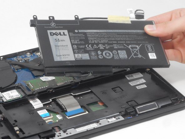

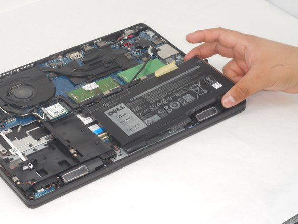

  4. Dell Latitude 5480 Battery Replacement, Battery: Schritt 4, Bild 1 von 2 Dell Latitude 5480 Battery Replacement, Battery: Schritt 4, Bild 2 von 2
    • Remove the four 5.6 mm Phillips screws that secure the battery.
  5. Dell Latitude 5480 Battery Replacement: Schritt 5, Bild 1 von 3 Dell Latitude 5480 Battery Replacement: Schritt 5, Bild 2 von 3 Dell Latitude 5480 Battery Replacement: Schritt 5, Bild 3 von 3
    • Lift the battery up and out of the chassis.
