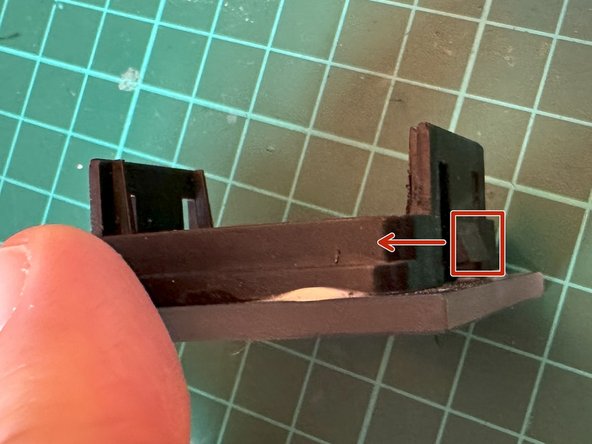

  2. Disassembling Netatmo Outdoor Camera Main Unit: Schritt 2, Bild 1 von 2 Disassembling Netatmo Outdoor Camera Main Unit: Schritt 2, Bild 2 von 2
    • Insert a flathead screwdriver into each hole at the front of the camera and push the two tabs to the centre and forwards.
    • It's hard to see, but you need the triangular part at the front, rather than what appears to be a tab at the back.
    • Pushing towards the centre allows the lens cover to come off. These can be done one at a time.

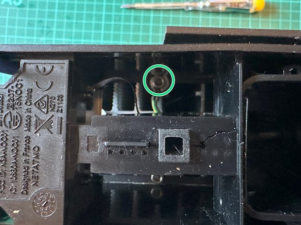

  3. Disassembling Netatmo Outdoor Camera Main Unit: Schritt 3, Bild 1 von 2 Disassembling Netatmo Outdoor Camera Main Unit: Schritt 3, Bild 2 von 2
    • Remove the six 2.5mm hex screws using a long Allen key.
    • One screw has an earthing ring wire. Don't forget this when reassembling.

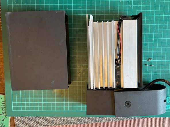

  5. Disassembling Netatmo Outdoor Camera Main Unit: Schritt 5, Bild 1 von 1
    • Using a 1.5mm hex screwdriver remove the four screws holding on the camera module.

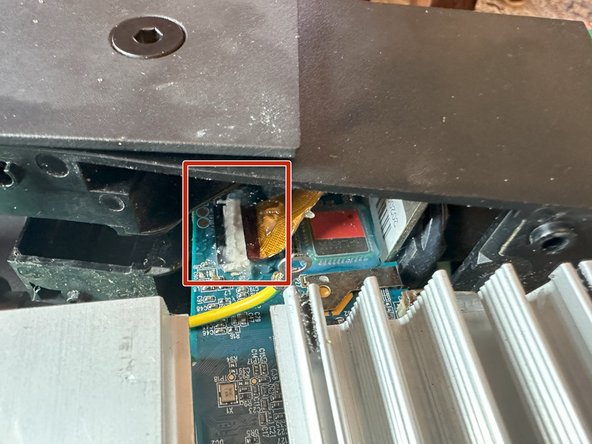

  6. Disassembling Netatmo Outdoor Camera Main Unit: Schritt 6, Bild 1 von 2 Disassembling Netatmo Outdoor Camera Main Unit: Schritt 6, Bild 2 von 2
    • From this point the housing can be worked up and diagonally to reveal the circuit board, and ribbon cable.
    • Be careful with both the camera module ribbon and the one for the LED lights (which cannot be removed).
    • Do not slide the circuit board within the heatsink otherwise you risk ripping the LED ribbon cable.
