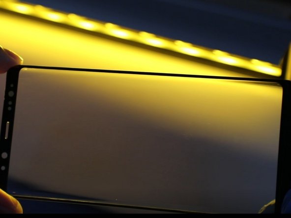

  5. Five Steps To Apply A New OCA On Samsung Galaxy Note 8 Edge Touch Glass, Using lamination machine: Schritt 5, Bild 1 von 2 Five Steps To Apply A New OCA On Samsung Galaxy Note 8 Edge Touch Glass, Using lamination machine: Schritt 5, Bild 2 von 2
    • After finishing the above steps, we put the whole set of mold into RMB-2 Laminating Machine for bonding.
    • For the whole process, the vacuum time we set is 30s and the lamination time is 10s, the total time for the lamination only needs 40s.
    • Now let’s see the final result after the lamination. There is no any bubble on the touch screen and the OCA’s position is completely unbiased and exactly overlap with touch screen. So the lamination effect is excellent.
