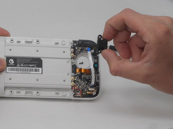

  8. GameSir X2 Type-C USB-C Port Replacement: Schritt 8, Bild 1 von 3 GameSir X2 Type-C USB-C Port Replacement: Schritt 8, Bild 2 von 3 GameSir X2 Type-C USB-C Port Replacement: Schritt 8, Bild 3 von 3
    • Identify where the ribbon wire connects to to the motherboard.
    • Flip the black locking ZIF flap holding the ribbon wire in place to the upward position.
    • Gently remove the ribbon cable away from the motherboard socket.

  9. GameSir X2 Type-C USB-C Port Replacement: Schritt 9, Bild 1 von 3 GameSir X2 Type-C USB-C Port Replacement: Schritt 9, Bild 2 von 3 GameSir X2 Type-C USB-C Port Replacement: Schritt 9, Bild 3 von 3
    • Once the cover is off of the plug and the ribbon wire is released from the flap, gently pull the USB-C plug away from the device.
