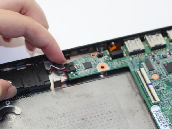

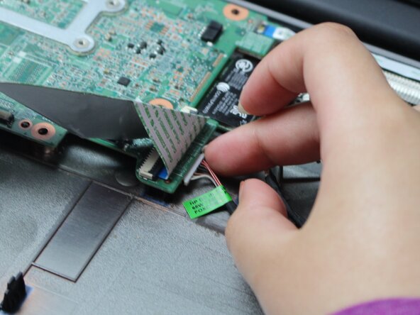

  8. HP Chromebook 14-SMB SSD Replacement: Schritt 8, Bild 1 von 3 HP Chromebook 14-SMB SSD Replacement: Schritt 8, Bild 2 von 3 HP Chromebook 14-SMB SSD Replacement: Schritt 8, Bild 3 von 3
    • Use your fingernails or the flat end of a spudger to disconnect the speaker and fan connectors from their motherboard sockets.
    • Flip up the black ZIF locking flaps of any ribbon cables connected to the motherboard.
    • Disconnect the ribbon cables.
    • Use your fingernails to disconnect the white connector on the underside of the motherboard.

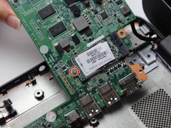

  10. HP Chromebook 14-SMB SSD Replacement: Schritt 10, Bild 1 von 2 HP Chromebook 14-SMB SSD Replacement: Schritt 10, Bild 2 von 2
    • Pull the motherboard a few millimeters to the right to unseat the ports from the chassis.
    • Turn the motherboard over.
    • Remove the single Phillips screw that secures the SSD.
    • The SSD will flip up a few millimeters after removing the screw. This is normal.
  11. HP Chromebook 14-SMB SSD Replacement: Schritt 11, Bild 1 von 1
    • Pull the SSD directly out of its motherboard port.
