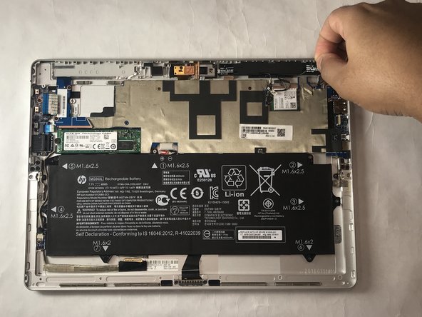

While the screen is facing down, remove six 3.0 mm Torx T5 screws under the stand.
