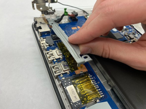

Using a Phillips #0 screwdriver, unscrew the 5.6mm screw on top connecting the shielding to the board.
Using a Phillips #0 screwdriver, unscrew the 3.2mm screw on the bottom connecting the shielding to the board.

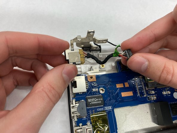

Lift the hinge.
Remove the long shielding that was under the hinge.
Remove and replace the charging port.
