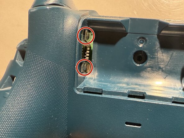

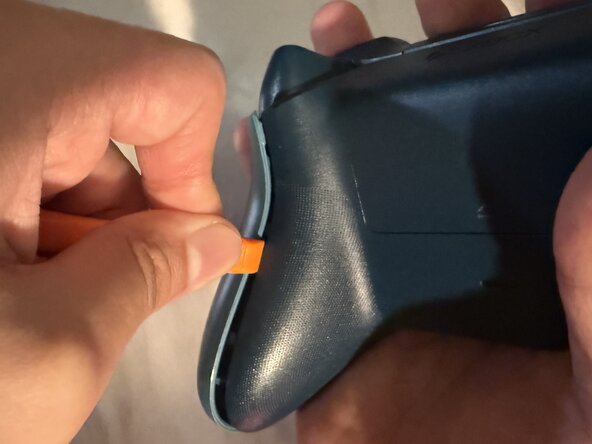

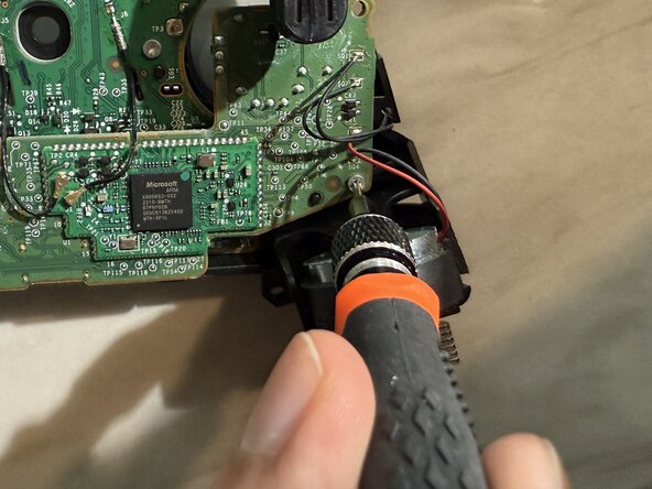

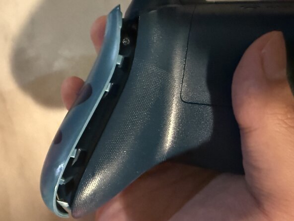

    • Before you begin, remove the two double-A (AA) batteries from the back of the controller.
    • Wedge your spudger into the seam between the back and side panels.
    • Grip the controller firmly and pry the side panel away by moving the spudger back and forth. Work your way around the entire seam using this motion.
  2. How to Fix Xbox Series (Model 1914) Controller Stick Drift Without Soldering: Schritt 2, Bild 1 von 3 How to Fix Xbox Series (Model 1914) Controller Stick Drift Without Soldering: Schritt 2, Bild 2 von 3 How to Fix Xbox Series (Model 1914) Controller Stick Drift Without Soldering: Schritt 2, Bild 3 von 3

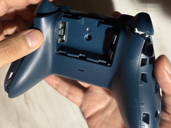

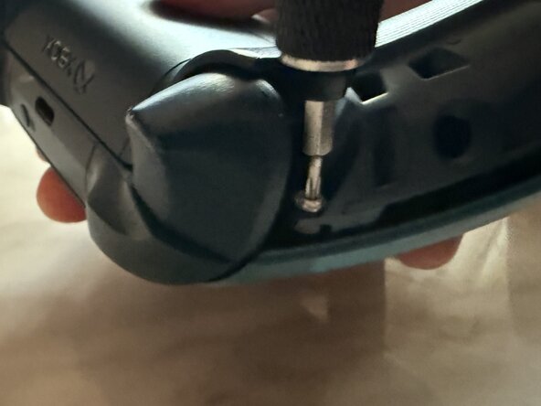

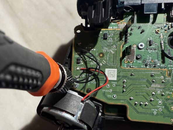

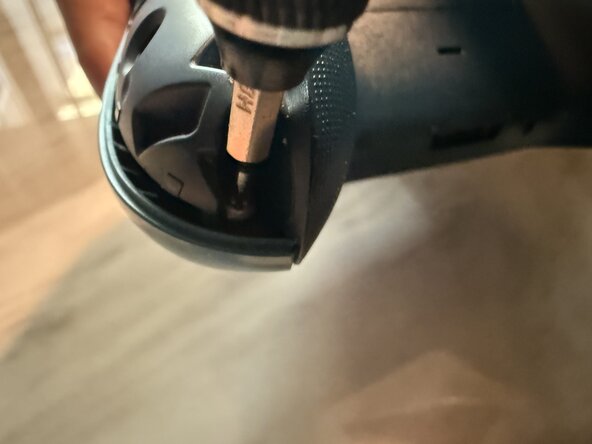

    • One of the five 2.4 mm screws is located in the middle of the battery container.
    • You can either peel the sticker or punch a hole through the center to access the 2.4 mm screw.
    • Remove the screw in the middle using the TR8 Torx screwdriver. Also, remove the two 2.4 mm screws on both sides of the controller.
  3. How to Fix Xbox Series (Model 1914) Controller Stick Drift Without Soldering: Schritt 3, Bild 1 von 1
    • Remove the back panel.

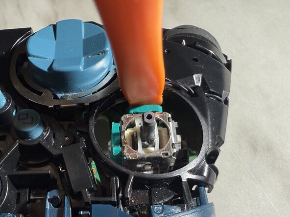

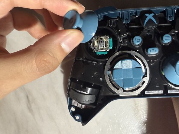

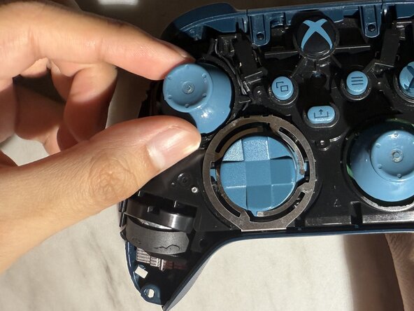

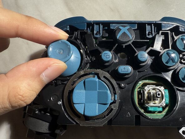

    • Turn the controller over and remove the front panel.
    • Remove both thumb sticks by pulling them up.

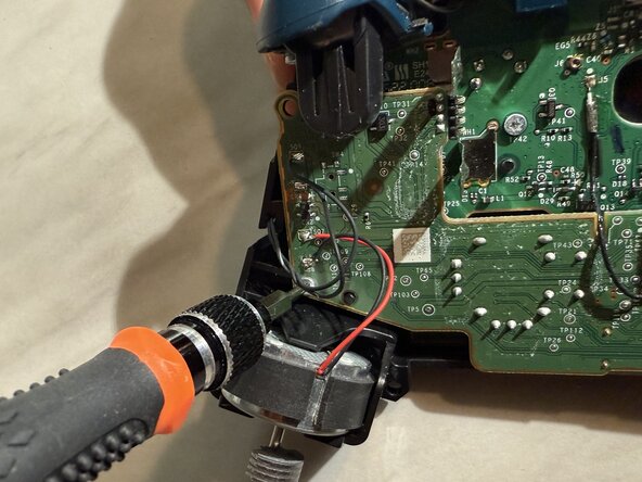

    • Turn the controller over and remove the two 1.75 mm screws using the T6 Torx screwdriver.

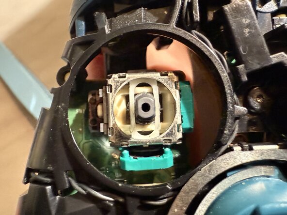

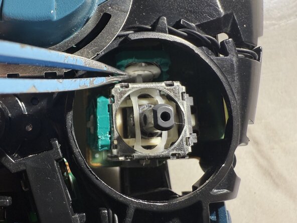

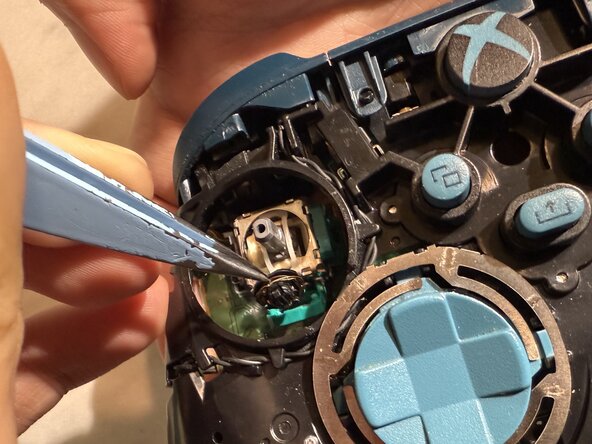

    • Do not use excessive force when you pry open the sensor housing since it can damage it.
    • Face the controller up, and with your tweezer, open the sensor housing by gently pushing away from the analog stick sensor.
    • Pull the old sensor wheel out of the sensor housing.

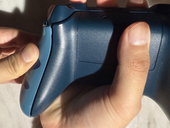

    • Push the side panels back in place.
