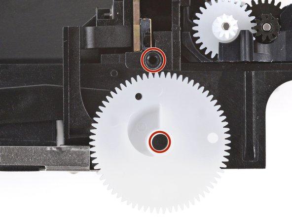

  2. How to Install the Film Door Lever and Right Gear In Your Polaroid Now (Gen 3), Right gear: Schritt 2, Bild 1 von 3 How to Install the Film Door Lever and Right Gear In Your Polaroid Now (Gen 3), Right gear: Schritt 2, Bild 2 von 3 How to Install the Film Door Lever and Right Gear In Your Polaroid Now (Gen 3), Right gear: Schritt 2, Bild 3 von 3
    • To correctly put the right gear back into place, line up the following:
    • The center hole on the gear goes on the plastic post on the right side of the camera.
    • The curved groove slots over the small, plastic peg just above the center post.
