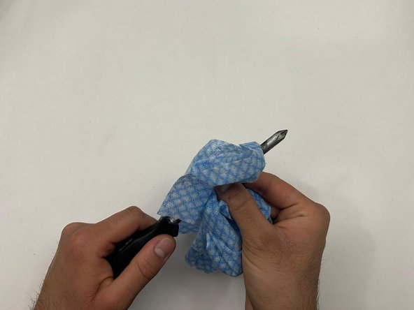

    • Use a clean rag to wipe the screwdriver to remove any dirt, grease, or debris.

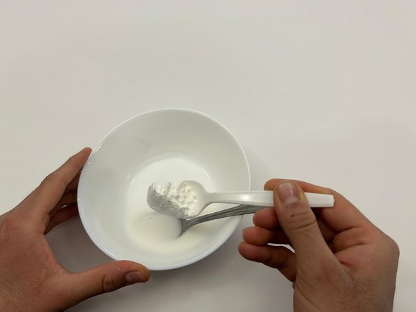

    • In a bowl, stir half a tablespoon of baking soda with 4 to 5 drops of water.
    • Add one eighth teaspoon of baking soda if the mixture is too runny, or 4 to 5 drops of water if the paste is too thick.
    • Adjust the amount of baking soda and water based on the size of the screwdriver.

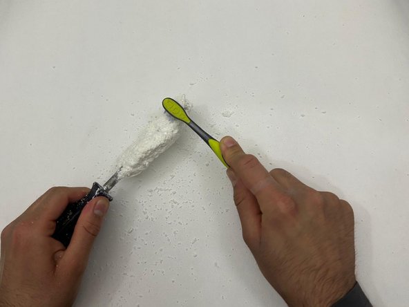

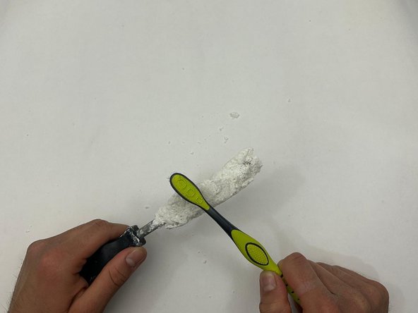

    • After 2 to 6 hours, use a toothbrush or some sort of brush to scrub the paste off the screwdriver.
    • Apply moderate pressure in back and forth and circle motions to effectively remove the rust.

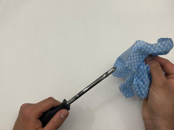

    • Using a clean rag, dry the screwdriver by wiping it in a back and forth motion.
    • Make sure the screwdriver is fully dry, otherwise the rust can return.
