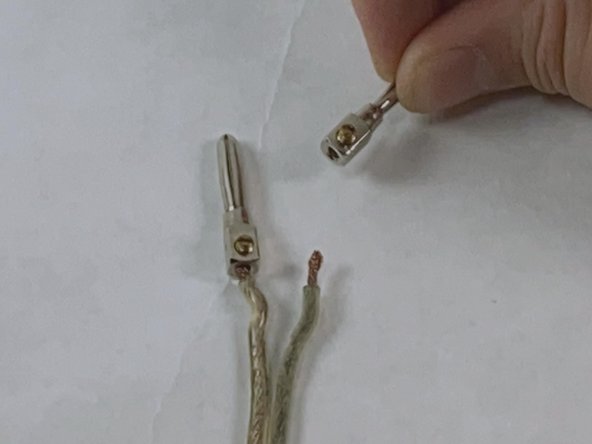

    • Partially unscrew the screws in the pins.
    • You should be able to pull off the pins from the wires easily when the screws are partially unscrewed.
    • Remove both the pins from the wires and set them aside.
    • Keep note of which wire corresponds to which pin. If you reassemble the cord with the wires in the wrong pins, the scoring system will fail.

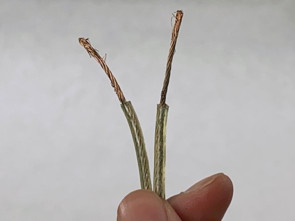

    • Practice caution when using the wire stripper to avoid cutting or scraping yourself.
    • Use the wire stripper to strip the plastic wire insulation about one inch below the location of the break.
    • Pull the plastic wire insulation off to expose the wire and its break.
  8. How to Repair a Break in the Wire of a Foil/Sabre Fencing Body Cord: Schritt 10, Bild 1 von 2 How to Repair a Break in the Wire of a Foil/Sabre Fencing Body Cord: Schritt 10, Bild 2 von 2
    • Repeat the above process for the second wire.
    • The length of exposed wire should be about the same across all wires.
  9. How to Repair a Break in the Wire of a Foil/Sabre Fencing Body Cord: Schritt 11, Bild 1 von 3 How to Repair a Break in the Wire of a Foil/Sabre Fencing Body Cord: Schritt 11, Bild 2 von 3 How to Repair a Break in the Wire of a Foil/Sabre Fencing Body Cord: Schritt 11, Bild 3 von 3
    • Cut the wire below the break while leaving about an inch of usable wire exposed.
    • Cut the second wire to make the wires approximately even in length.

    • Slip the wires back into the pins. Make sure you put the wires back into the pins they were originally in.
    • Screw the pins back into place.
    • Make sure the pins are screwed tight enough to securely hold the wires in place.

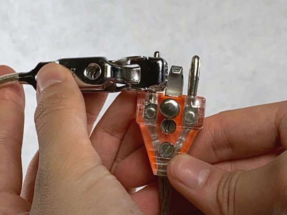

    • Reinsert the button.
    • Reinsert the metal clip.
    • Screw the metal clip back into the button.
