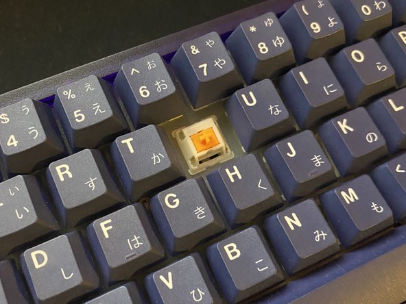

    • Align the keycap puller to the keycap.
    • Gently pull vertically on the keycap to remove it, exposing the key switch.
  2. How to Replace KBD67 Lite R3 Keyboard Switch Spring: Schritt 2, Bild 1 von 3 How to Replace KBD67 Lite R3 Keyboard Switch Spring: Schritt 2, Bild 2 von 3 How to Replace KBD67 Lite R3 Keyboard Switch Spring: Schritt 2, Bild 3 von 3
    • Align the key switch puller with the key switch that you're removing.
    • Pull the key switch out of the keyboard.

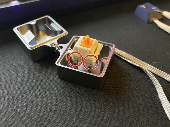

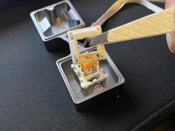

  3. How to Replace KBD67 Lite R3 Keyboard Switch Spring: Schritt 3, Bild 1 von 3 How to Replace KBD67 Lite R3 Keyboard Switch Spring: Schritt 3, Bild 2 von 3 How to Replace KBD67 Lite R3 Keyboard Switch Spring: Schritt 3, Bild 3 von 3
    • Locate the side of the switch that has latches.
    • Place the side of the switch with latches on top of the key switch opener legs.
    • Apply gentle force pushing the switch down on the switch opener to open up the switch.

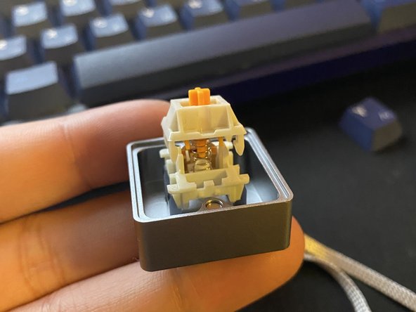

  4. How to Replace KBD67 Lite R3 Keyboard Switch Spring: Schritt 4, Bild 1 von 2 How to Replace KBD67 Lite R3 Keyboard Switch Spring: Schritt 4, Bild 2 von 2
    • Remove the top housing and stem to reveal the switch spring.
    • Remove the switch spring and proceed to replace it with another spring of your choice.
