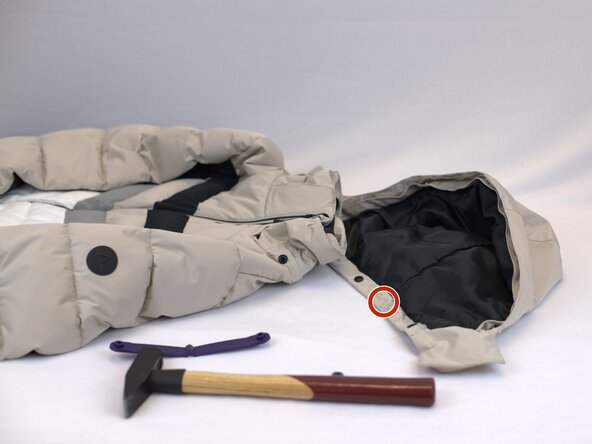

  1. How to Replace the Button on a Ski Jacket, Locate the repair: Schritt 1, Bild 1 von 3 How to Replace the Button on a Ski Jacket, Locate the repair: Schritt 1, Bild 2 von 3 How to Replace the Button on a Ski Jacket, Locate the repair: Schritt 1, Bild 3 von 3
    • Identify where the button fell off.
    • Prepare the tools needed for the repair.
    • Tip: Many garments come with a spare button on the inside, sewn to the care label. Check there, before buying a new button.

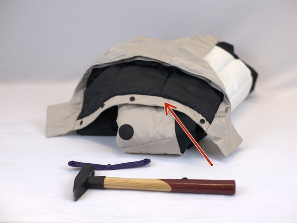

  2. How to Replace the Button on a Ski Jacket, Prepare the area: Schritt 2, Bild 1 von 2 How to Replace the Button on a Ski Jacket, Prepare the area: Schritt 2, Bild 2 von 2
    • Locate the area where the new button will be placed
    • Make a small cut on the seam (green circle) to allow space for the "punch tool" to be inserted.
    • Gently insert the "punch tool" and prepare for next steps.
