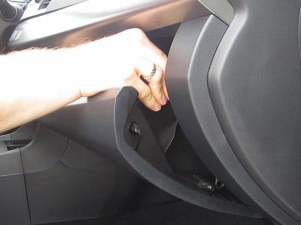

Open the glove box and empty all of its contents.
Gently push the glove box damper arm on the right side of the glovebox to the right, you can release it. The latch will be released by a pin, and the arm will be lifted out of the aperture.
Push the two locking tabs on the front left and right in towards the center with your fingers and pull off the cover.

Push both sides of the glove box inwards the same way as in Step 2 and push it back into the housing
Gently reinstall the damper arm on the right side of the glovebox by pushing it back into the aperture. The latch will lock back in, and the arm will be connected to the aperture.
Close the glove box and put your items back inside. You've completed the task!
