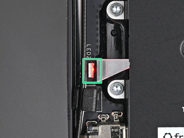

    1. How to Reset the Mainboard in your Framework Laptop 13, Plug the laptop in: Schritt 7, Bild 1 von 2 How to Reset the Mainboard in your Framework Laptop 13, Plug the laptop in: Schritt 7, Bild 2 von 2
      • Plug the laptop into a power source.
      • The red status LED near the right Expansion Card slots should blink continuously. If this LED isn't blinking, the laptop isn't receiving power correctly—try another USB-C port.
      • Don't proceed unless the LED is blinking.
