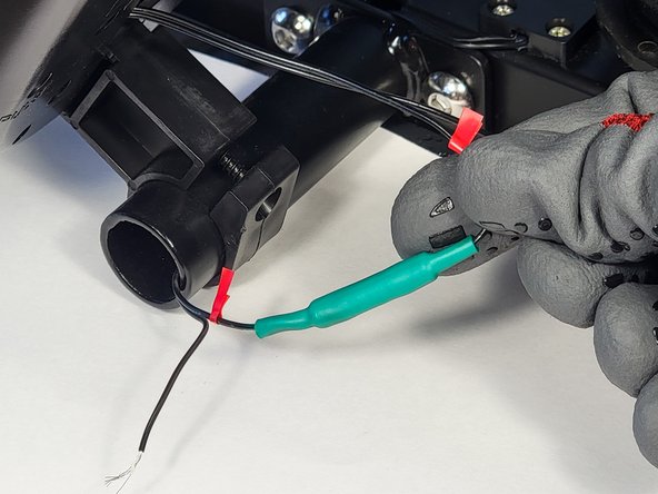

    • Determine the correct orientation of the broken plastic connector on the sensor cables.
  2. How to Rewire a Broken Sensor Cable on an MBH Fitness Water Rowing Machine: Schritt 2, Bild 1 von 1
    • In the correct orientation, mark the wires that are opposite to each other with colored tape.
    • Use your fingers to widen the space between the two wires to mark with the colored tape more easily.

    • Put one of the marked wires through a heat shrink tube.
  9. How to Rewire a Broken Sensor Cable on an MBH Fitness Water Rowing Machine: Schritt 9, Bild 1 von 3 How to Rewire a Broken Sensor Cable on an MBH Fitness Water Rowing Machine: Schritt 9, Bild 2 von 3 How to Rewire a Broken Sensor Cable on an MBH Fitness Water Rowing Machine: Schritt 9, Bild 3 von 3
    • Using that same wire, firmly place the exposed wire into one end of the crimp terminal.
    • Twist the exposed wire end to prevent fraying.

    • Pull on both wires to test the strength of the crimping. The wires should not move.
  14. How to Rewire a Broken Sensor Cable on an MBH Fitness Water Rowing Machine: Schritt 14, Bild 1 von 2 How to Rewire a Broken Sensor Cable on an MBH Fitness Water Rowing Machine: Schritt 14, Bild 2 von 2
    • Caution: Hot air from a hair dryer or heat gun can cause burns.
    • Cover the crimping terminal completely with the heat shrink tube.
    • Blow HOT air from the blow dryer or heat gun onto the heat shrink tubing, moving side to side, until it shrinks to closely fit the crimping terminal and the wires.
    • The heat shrink tubing protects the newly connected wires from water and the environment. Shrinking the tube to closely fit the crimping terminal and the wires creates better protection.

    • Repeat Steps 8-14 for the remaining two wires.
