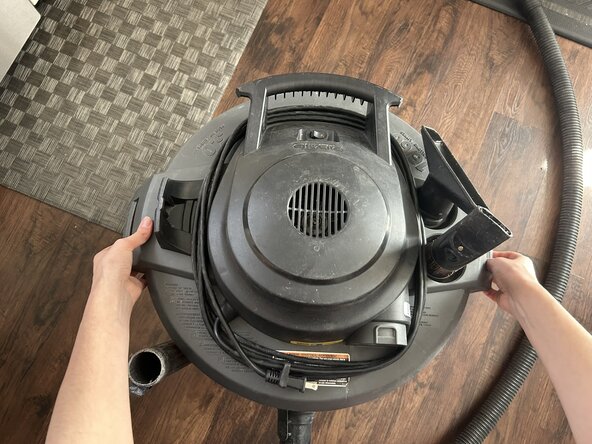

    • Ensure that your vacuum can suck up water, using a regular vacuum could cause damage to the vacuum.
    • Before setting up, open your wet vacuum so it’s ready for use.

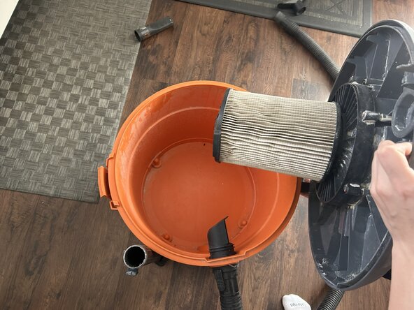

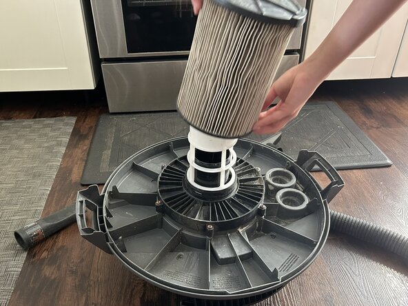

    • Check the settings on your vacuum to see if your filter is good for wet or dry use.
    • Remove the filter to avoid potential damage.
    • As a precaution, it's recommended to remove the filter even if it's designed for wet use to prevent potential damage over time.

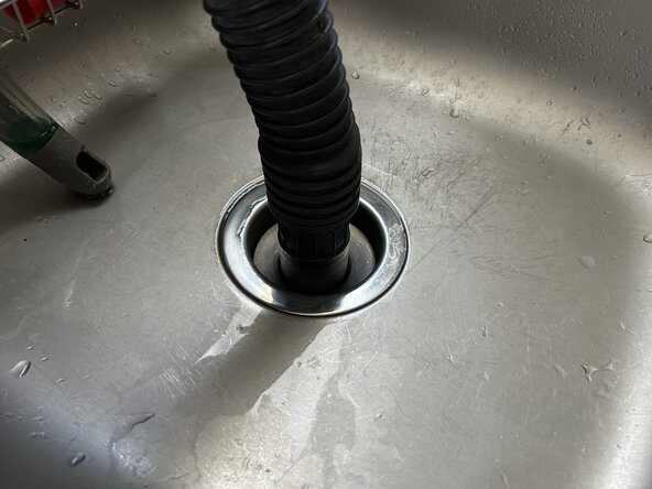

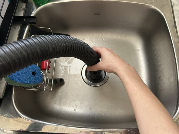

    • Position the vacuum hose directly over the drain.
    • Press the hose firmly against the drain.
    • If needed, add an inch of water to the sink before attaching the hose, this can help improve suction.
  7. How to Unclog a Sink Using a Wet Vacuum: Schritt 7, Bild 1 von 3 How to Unclog a Sink Using a Wet Vacuum: Schritt 7, Bild 2 von 3 How to Unclog a Sink Using a Wet Vacuum: Schritt 7, Bild 3 von 3
    • Switch the vacuum to wet mode and turn it on.
    • Hold the hose over the drain for about two minutes to pull up the clog.

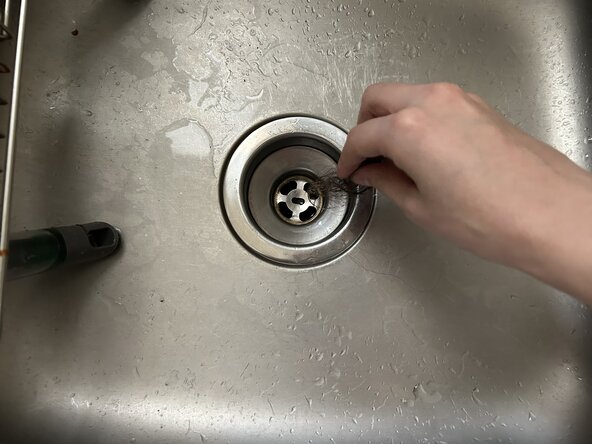

    • The vacuum tank may fill up quickly, so be prepared to empty it once or twice during the process.
    • Check the vacuum hose for debris every few minutes.
    • If hair or gunk comes up, remove it by hand or with needle-nose pliers before continuing.
  9. How to Unclog a Sink Using a Wet Vacuum: Schritt 9, Bild 1 von 2 How to Unclog a Sink Using a Wet Vacuum: Schritt 9, Bild 2 von 2
    • Remove the hose from the sink.
    • Run water to see if the clog is cleared. If water still drains slowly, repeat the process or consider seeking professional assistance.
