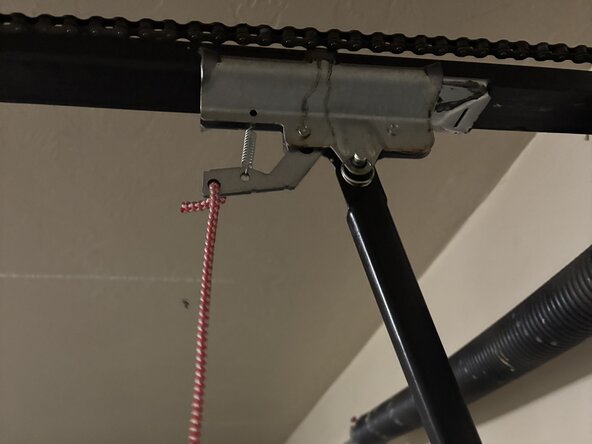

  1. How to Use a Garage Door Opener Emergency Cord, How to Use a Garage Door Opener Emergency Cord: Schritt 1, Bild 1 von 3 How to Use a Garage Door Opener Emergency Cord, How to Use a Garage Door Opener Emergency Cord: Schritt 1, Bild 2 von 3 How to Use a Garage Door Opener Emergency Cord, How to Use a Garage Door Opener Emergency Cord: Schritt 1, Bild 3 von 3
    • Make sure the garage door is in the closed position before pulling the emergency release. This prevents the door from crashing down unexpectedly.

  2. How to Use a Garage Door Opener Emergency Cord: Schritt 2, Bild 1 von 3 How to Use a Garage Door Opener Emergency Cord: Schritt 2, Bild 2 von 3 How to Use a Garage Door Opener Emergency Cord: Schritt 2, Bild 3 von 3
    • Firmly pull the emergency release cord straight down.
    • This action disengages the trolley from the opener carriage, allowing you to manually move the door.
    • After pulling the cord, gently lift the garage door to ensure it moves freely. If it does not, there may be an issue with the door's balance or track alignment.

  3. How to Use a Garage Door Opener Emergency Cord: Schritt 3, Bild 1 von 3 How to Use a Garage Door Opener Emergency Cord: Schritt 3, Bild 2 von 3 How to Use a Garage Door Opener Emergency Cord: Schritt 3, Bild 3 von 3
    • Once the situation is resolved, re-engage the garage door opener by manually moving the door until the trolley reconnects with the carriage.
    • Some models may require pulling the emergency release cord in the opposite direction to re-engage.
    • Open and close the door using the remote or wall switch to make sure it is functioning properly.
