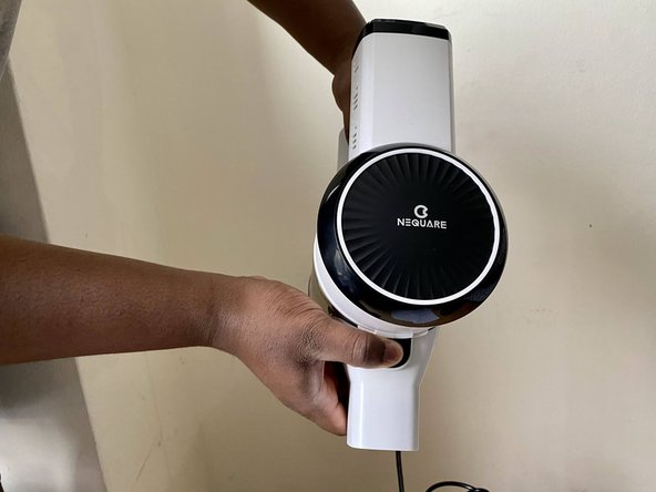

Locate the black button to release the white motor unit from the rest of the vacuum cleaner.
Hold down the black button to remove the white motor unit above and gently pull the motor unit upwards.

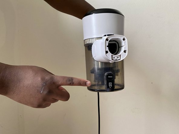

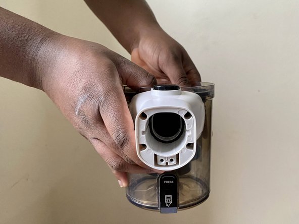

Press the release button at the side of the dust canister to dispose of the debris.

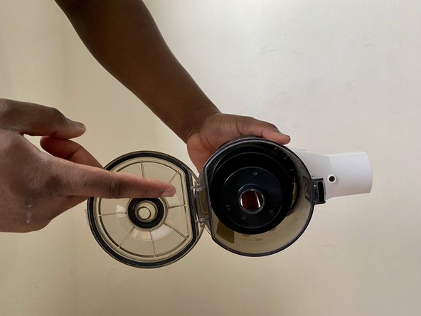

After emptying the debris, hold down the black button, then twist and pull the canister out.
Clean both the canister and the black part either by rinsing it out or using a wash cloth.
