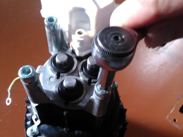

    4. Kärcher K3.86 Cylinder Head Replacement, Hold the piston guidance in place: Schritt 4, Bild 1 von 3 Kärcher K3.86 Cylinder Head Replacement, Hold the piston guidance in place: Schritt 4, Bild 2 von 3 Kärcher K3.86 Cylinder Head Replacement, Hold the piston guidance in place: Schritt 4, Bild 3 von 3
      • Firmly hold the piston guidance.
      • In order to protect the inside of the pump from dust, reposition the 4 screws to hold the piston guidance in place.
