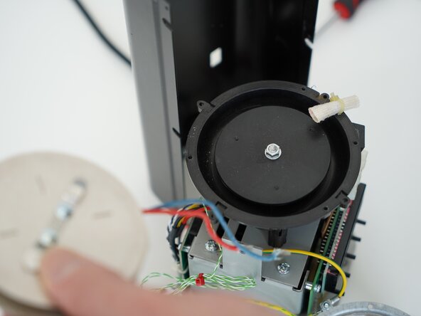

  8. Kaffelogic Nano 7/LINK (A/B/C-N Serial) Element Replacement, Remove the element chamber: Schritt 8, Bild 1 von 2 Kaffelogic Nano 7/LINK (A/B/C-N Serial) Element Replacement, Remove the element chamber: Schritt 8, Bild 2 von 2
    • Lift the element chamber up carefully to expose the element. Set this aside.

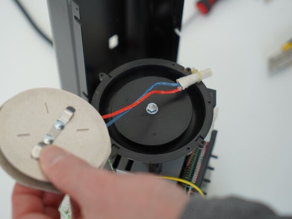

  9. Kaffelogic Nano 7/LINK (A/B/C-N Serial) Element Replacement, Remove support ring: Schritt 9, Bild 1 von 3 Kaffelogic Nano 7/LINK (A/B/C-N Serial) Element Replacement, Remove support ring: Schritt 9, Bild 2 von 3 Kaffelogic Nano 7/LINK (A/B/C-N Serial) Element Replacement, Remove support ring: Schritt 9, Bild 3 von 3
    • Lift up the element slightly and remove the support ring.
    • Do not touch the element coil directly. Skin oils can create hotspots on the wire.

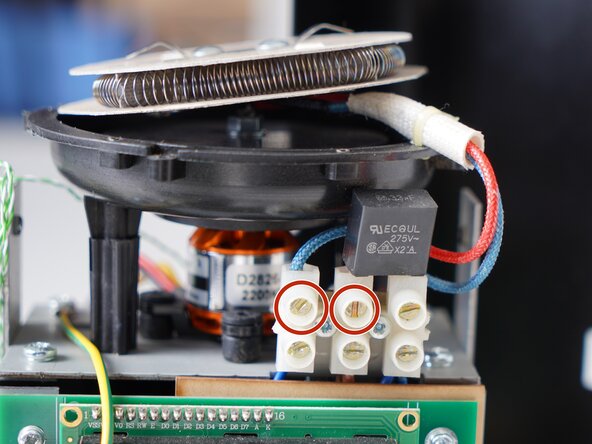

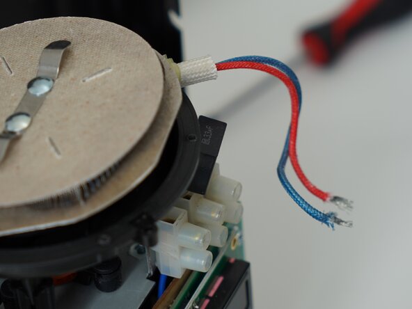

  10. Kaffelogic Nano 7/LINK (A/B/C-N Serial) Element Replacement, Disconnect the element: Schritt 10, Bild 1 von 3 Kaffelogic Nano 7/LINK (A/B/C-N Serial) Element Replacement, Disconnect the element: Schritt 10, Bild 2 von 3 Kaffelogic Nano 7/LINK (A/B/C-N Serial) Element Replacement, Disconnect the element: Schritt 10, Bild 3 von 3
    • Use a flathead screwdriver to remove the element leads from the terminal block.

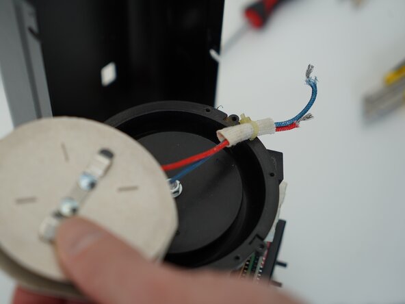

  11. Kaffelogic Nano 7/LINK (A/B/C-N Serial) Element Replacement, Remove the element: Schritt 11, Bild 1 von 3 Kaffelogic Nano 7/LINK (A/B/C-N Serial) Element Replacement, Remove the element: Schritt 11, Bild 2 von 3 Kaffelogic Nano 7/LINK (A/B/C-N Serial) Element Replacement, Remove the element: Schritt 11, Bild 3 von 3
    • Pull the element leads through the fibreglass tubing to remove the element.

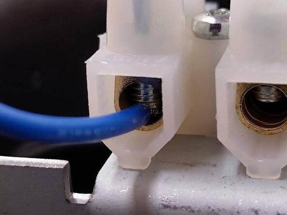

  12. Kaffelogic Nano 7/LINK (A/B/C-N Serial) Element Replacement, Checking the connections: Schritt 12, Bild 1 von 2 Kaffelogic Nano 7/LINK (A/B/C-N Serial) Element Replacement, Checking the connections: Schritt 12, Bild 2 von 2
    • Double check the cable position, so that the screw is coming down on the wire and not the insulation of the element.
